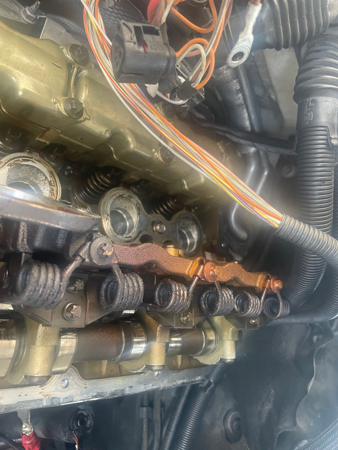

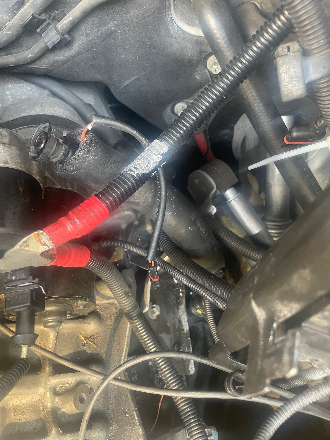

Wiring harness, wish the rest was this easy…

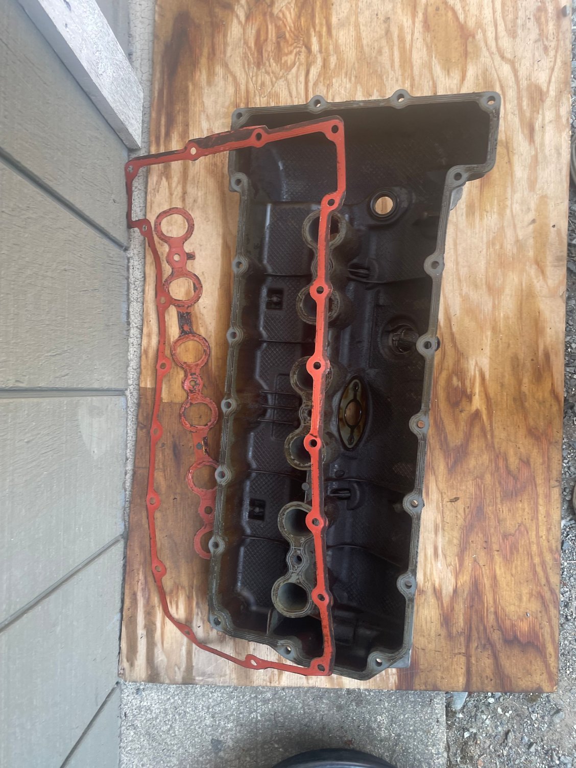

So the gasket feels like it’s metal, bends like it too. Find that to be pretty odd. Is there something that goes between that and the block? Planning on replacing it anyways, I believe there will be more votes for getting original BMW parts and not third party? Also, as I was cleaning the cover ( the picture shows prior to cleaning) I noticed it looked as if there was a bit of rust in it. Would cleaning it be enough to not worry afterwards? If so, recommendation for cleaner? Was using brake cle.

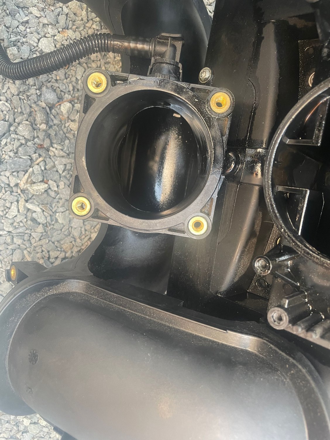

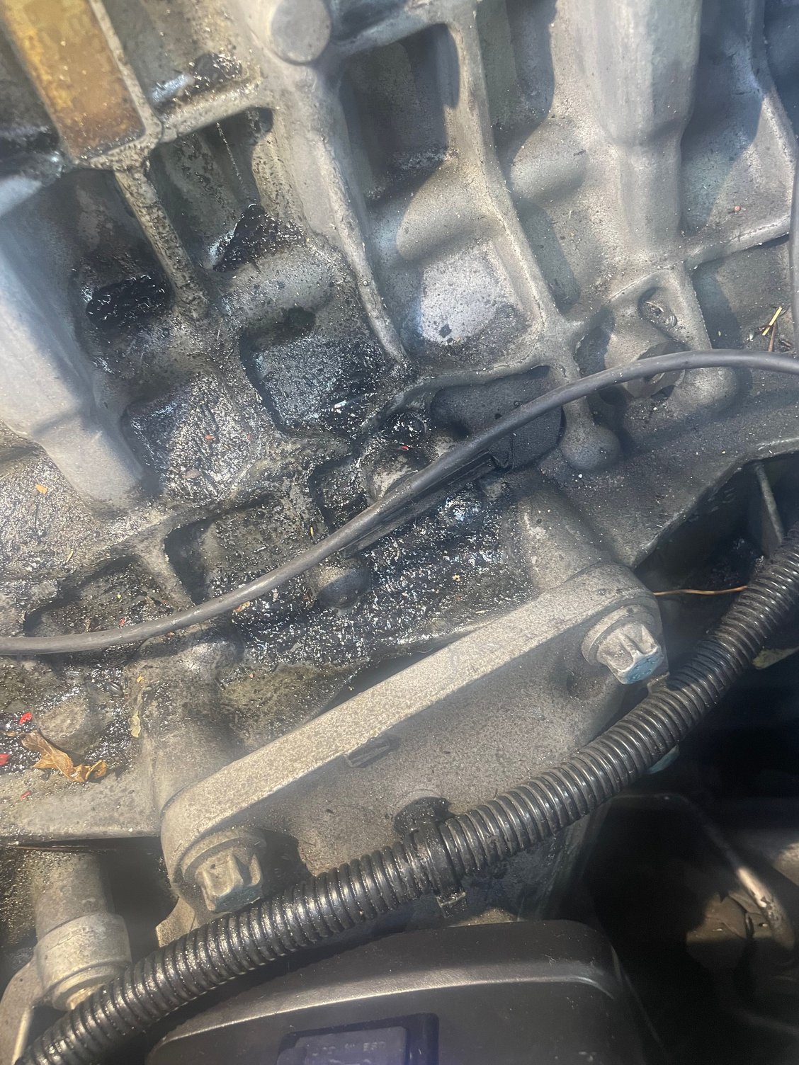

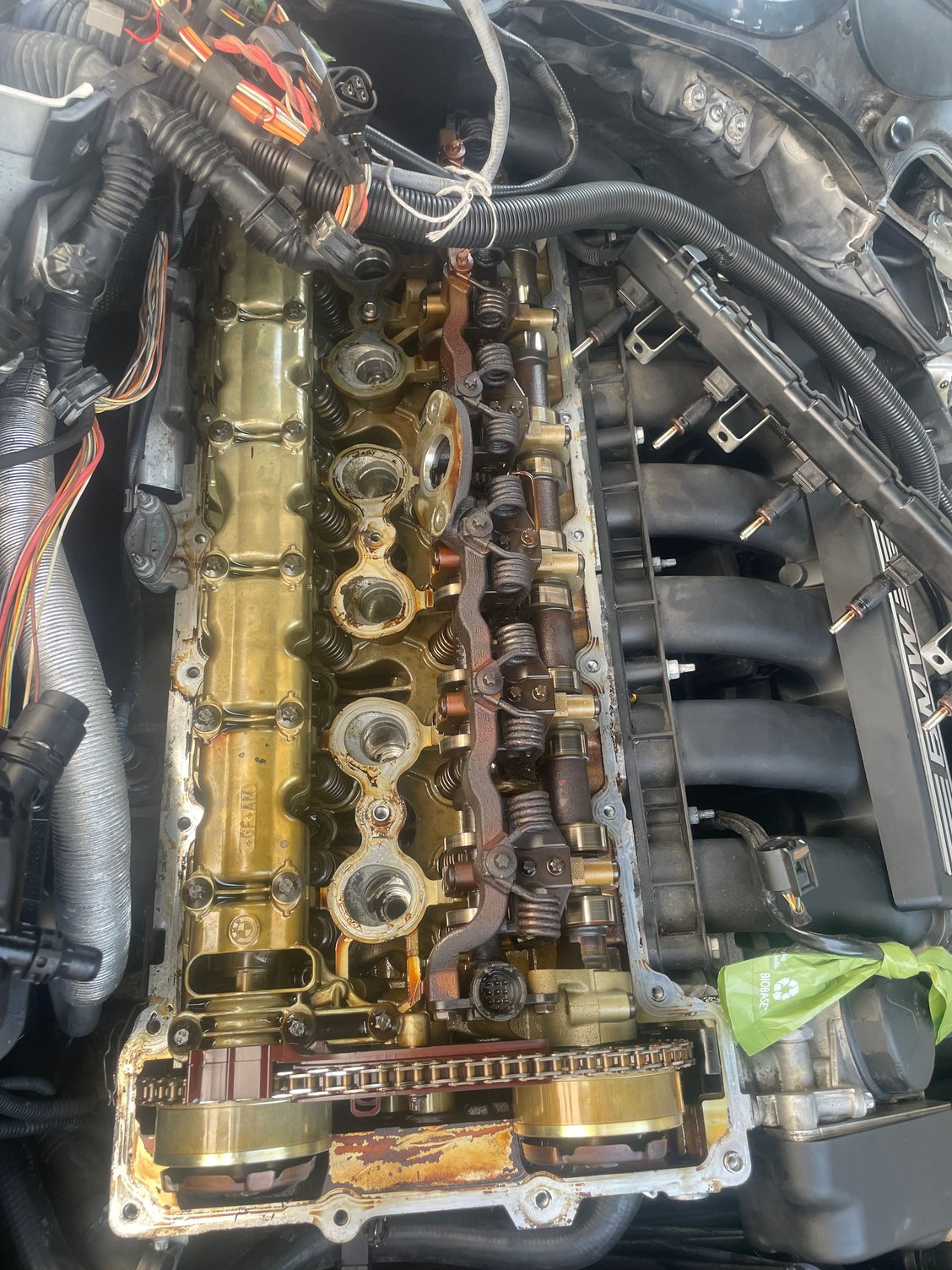

When I was finally able to get the intake manifold out I had a few drops of oil falll.
At first I was worried about the oil but it seems it may not be to bad. What do you guys think? Also, should I clean this up a bit? If so, is the cleaner I use for valve cover going to be ok?

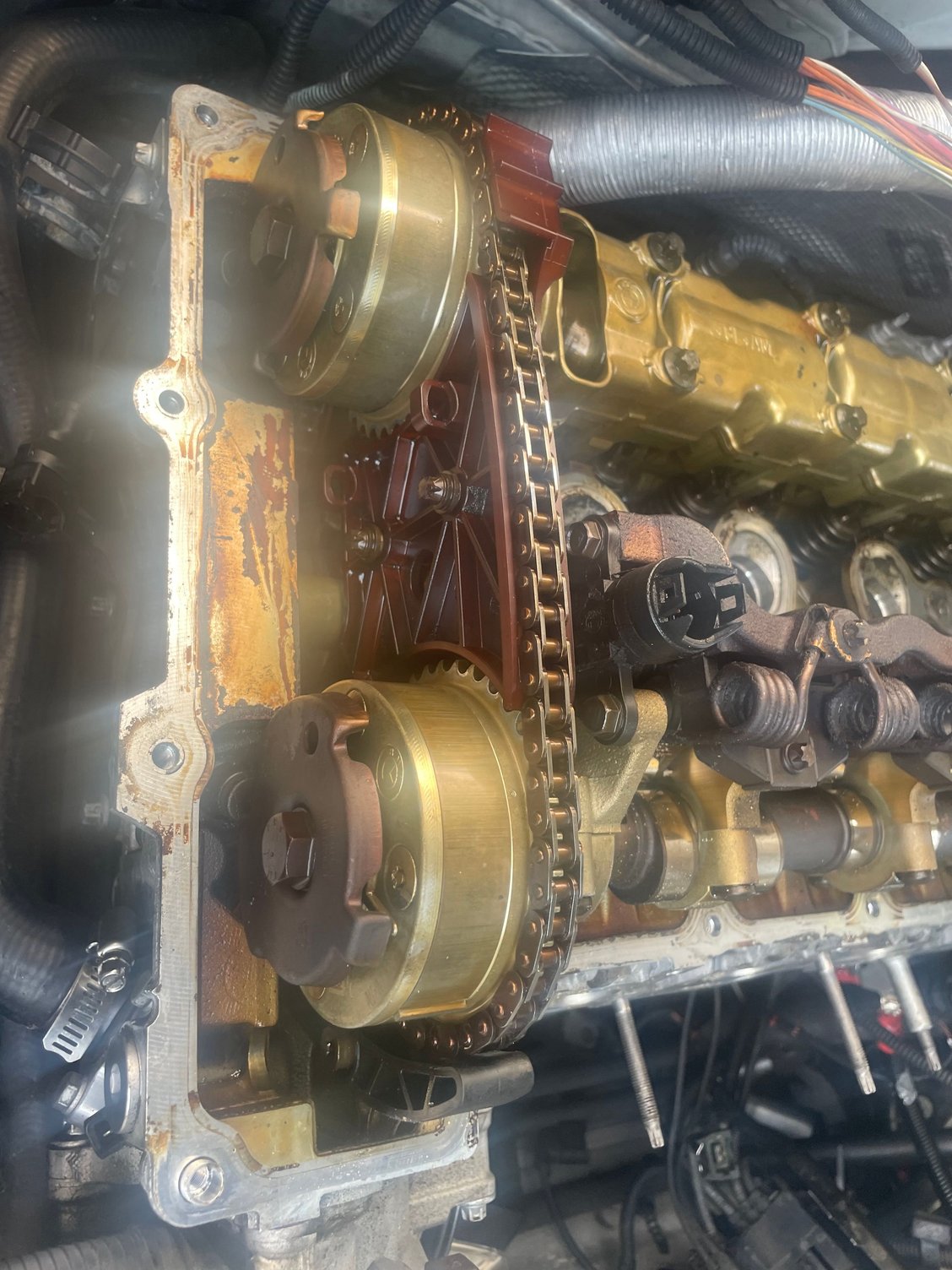

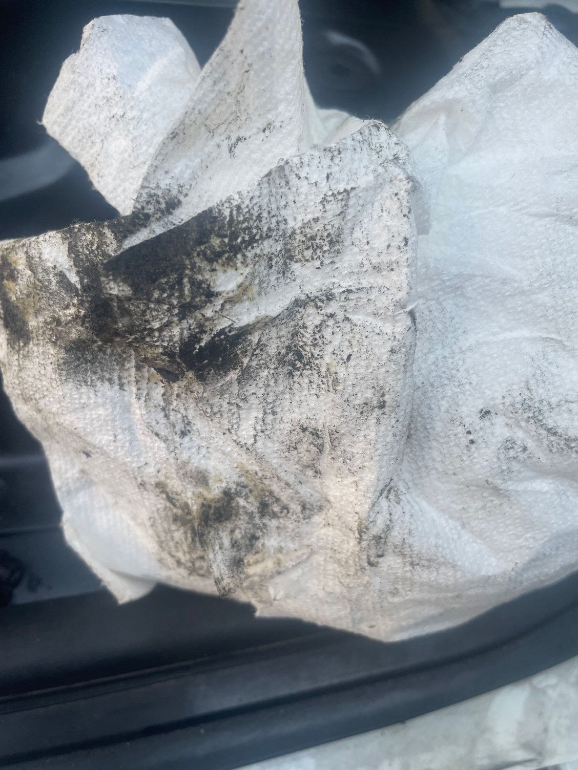

This is a bit concerning as at first glance I thought it was shining
I took a paper towel to it and wiped a bit up, I don’t see any shaving but I don’t have a magnet on hand right now so will grab one tomorrow and check again.

Your engine looks clean for the miles. They all get like that with the rust look. The gasket is just old. They are and should be rubber. You don't have to go BMW and if you don't be sure to go OEM. Gaskets are gaskets just get a known brand. Things that make the car run is what's important to be OEM or BMW. Your PCV system having oil is normal just change out the system and it'll be fine. You could clean it up a bit.
Thanks for the reply and information, really appreciate it. Seems that what I need to be concentrating on are the connections and the control units themselves since, other than normal high mile maintenance needs and a good polish, the engine is in fairly decent condition. Thats good news for sure, but man I think I would rather deal with the engine than electrical stuff
While I have it all taken apart, and since my knowledge is mere videos, is there something that I should consider checking/doing prior to putting it back together (not to include checking/fixing causes for the faults)?
