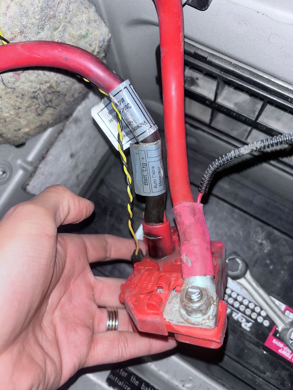

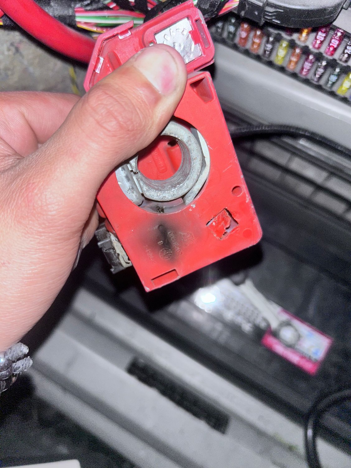

Let me put you in context with this story, yesterday I got an alert saying ''Battery isn't charging'', I was close to home so I put full gas to get, once I got in home, i check the positive terminal, was overheating, and the car didn't turn on, my friend jumped the car (the same who made the shortcircuit haha)
So, I drove again around the hood, all okay, but I saw a lot of voltage dropping on the hidden menu from 13v to 11.8 when applying brakes.
Today I changed the alternator and the battery died, jumped again and could drive normally. Arrived home, turn off and on back again the car and the same positive terminal was very hot.
Drove around the hood again and suddenly turned off the car, didn't star with a jumper, I was very nervious, tried everything so I have to pull to home, just going downhill.
Once I arrived, checked the voltage with a multimeter and said 12.8v, and magically the car turned on again, removed the positive terminal to ensure the new alternator really works well and yes it does, 13.5 - 13.7v as normal with lights off.
Then I left the car on 10 minutes and again it gets very hot.
I'm trying to figure out whats goin on, never had this issue before, so I'll tell you guys everything that happens soon, let me know if it's better idea to make a new threat. Greetings!
