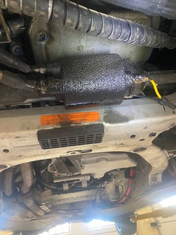

Default Active steering sway bar seepage
There's oil residue, any way to fix this seepage?
where do these two braided lines go to?
Thanks

It's actually the oil pan gasket that's leaking, working on replacing that now
