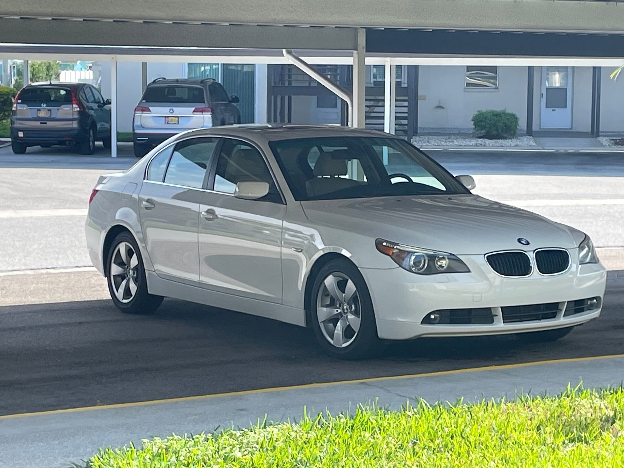

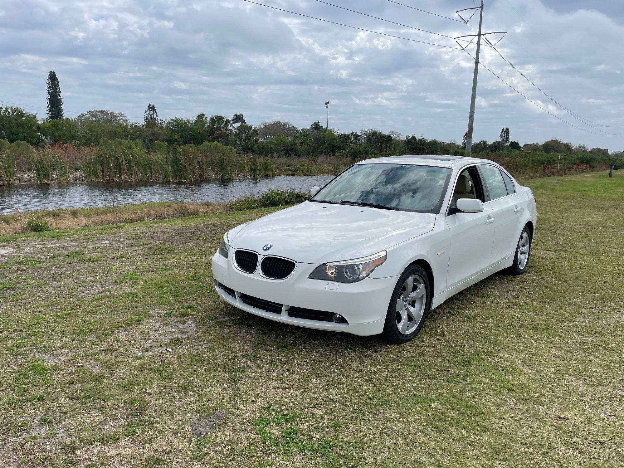

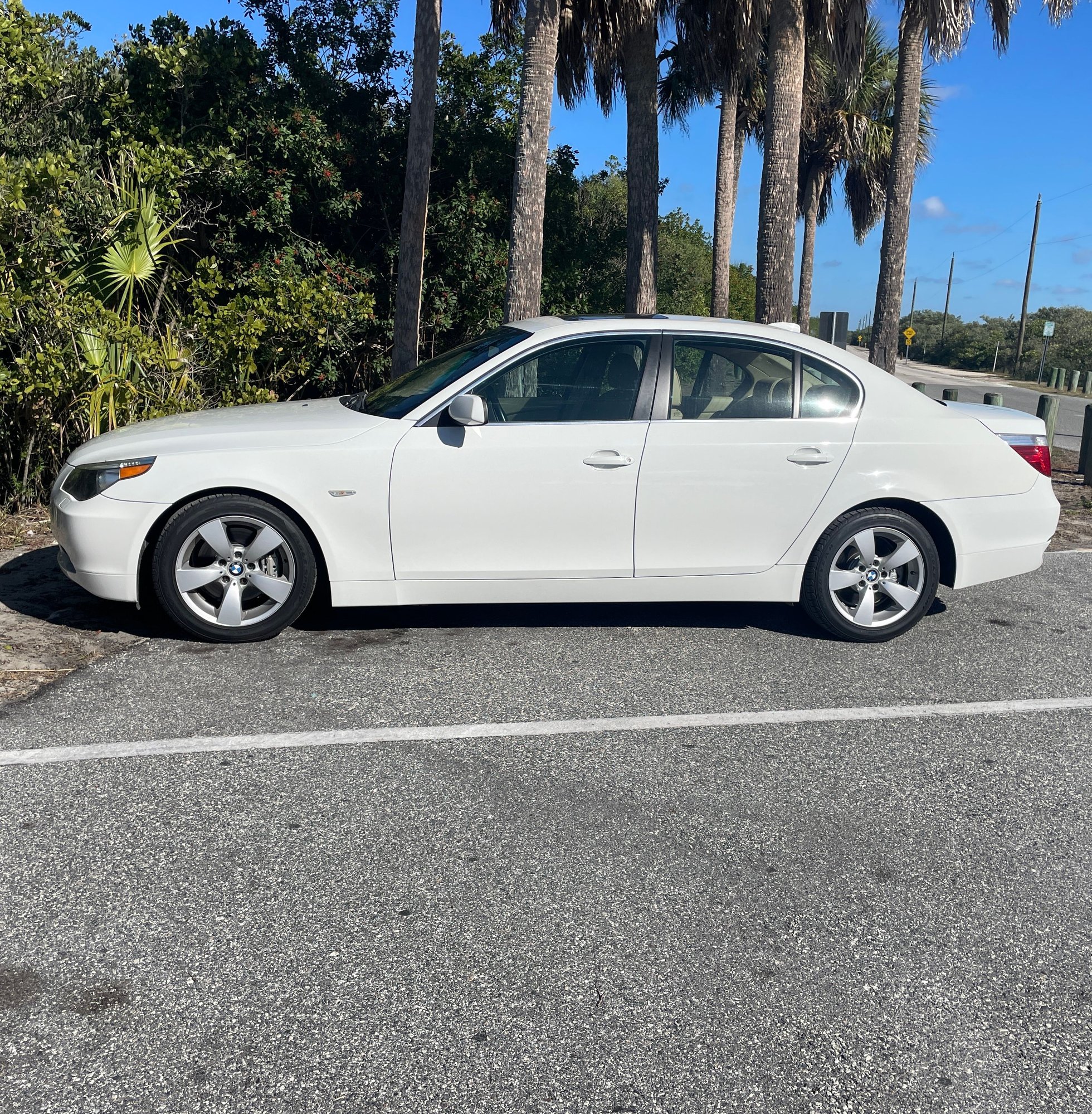

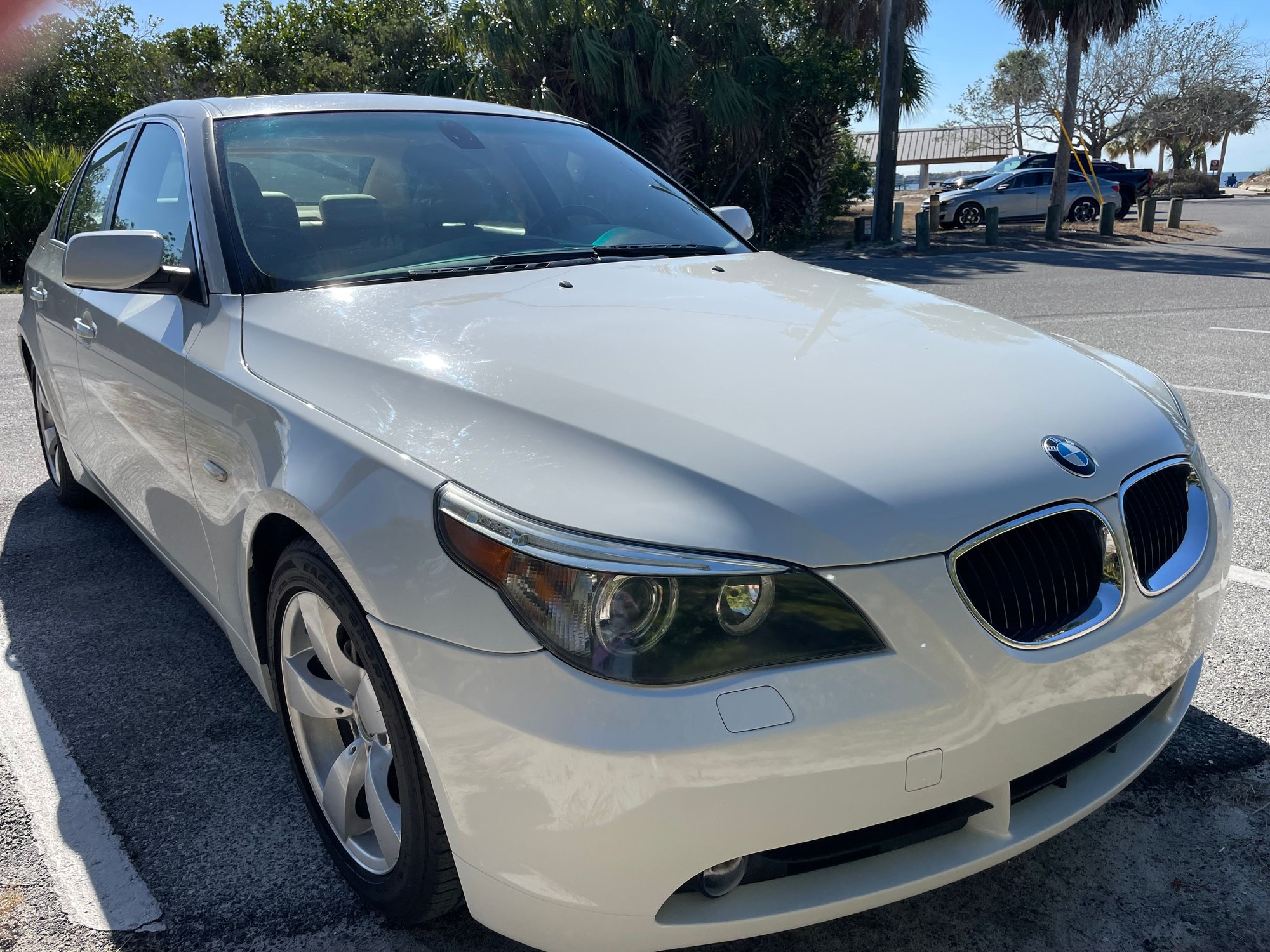

I'll get to my audio loss question but first...Hello a first post for me a NY'er retired to Florida 10 years now, I stumbled across a low mile 04 530i last year that I couldn't pass up , It's got 61k original, a Florida car since new, never hit, clean title ceramic coated Alpine White paint, garaged always & it shows, looks new this thing . It had an oil leak the guy disclosed which I fixed by running Rotella 15w/40 semi synthetic & this 20 year old car loves it , I run Citgo 90 octane ethanol free fuel exclusively & Tecron every other tankful. I'll post some pictures if I can.
